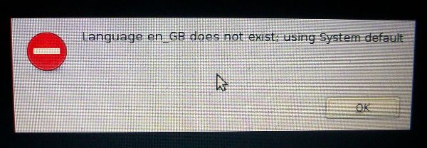

Mint 14 MATE works. Works fine, except for one thing... I get an error message on startup:
language en_GB does not exist using system default
I click past this and it works.
Anyone know how to sort this error?
Ta

Postby heiowge » Wed Jan 16, 2013 10:05 am
xenopeek wrote:Possibly. What is the output of the following command?
Code: Select all
locale -a

Postby xenopeek » Wed Jan 16, 2013 11:14 am
So it looks like en_GB is supported; I hope it's not a case sensitive thing... Can you take a screenshot of the message when you get it? Share it on tinypic.com or similar free image host.

Postby heiowge » Thu Jan 17, 2013 9:18 am
The screen pops up just before I get a desktop. It might be too early to screenshot, but I'll give it a go...
Posts: 1909
Postby heiowge » Thu Jan 17, 2013 9:27 am
Screenshot didn't take. Try this:
Posts: 1909
Postby xenopeek » Thu Jan 17, 2013 10:49 am
Right, but is this before, at or after the login screen :)

Postby heiowge » Thu Jan 17, 2013 2:45 pm
There's no login screen. Login is automatic.

Postby xenopeek » Thu Jan 17, 2013 4:28 pm
Okay, found it I think. Edit your /etc/default/locale file as root (gksudo pluma /etc/default/locale). The first line is probably:
Code: Select all
LANG="en_GB.UTF-8"
If there isn't a line that sets LANGUAGE also, add it as follows. If there is, but doesn't have the .UTF-8 bit then add that. It should be set the same as your LANG variable.
Code: Select all
LANGUAGE="en_GB.UTF-8"
Then reboot to activate.
Found through an old bug report on GDM, on which MDM is based that Linux Mint uses. Here: https://bugs.launchpad.net/ubuntu/+source/gdm/+bug/185947. Comments #15 and further were the helpful ones.

Postby heiowge » Thu Jan 17, 2013 9:23 pm
Made the change to the second line. It previously read "...GB:en" on the end.
No luck though. I got the same error on startup.
That link appears to be dead. It went to another error screen. :cry:

Postby heiowge » Fri Jan 18, 2013 9:48 am
Fixed it!!! :D
I had a look around the MATE section of the Mint forums.
It seems that if I log out and then change the default language to English (GB) in the login screen, the session confirms the default change and then doesn't have the error again.
I just wish they'd build it into the install...
